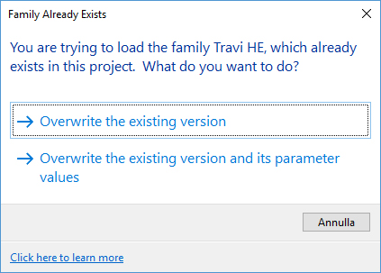

Hello everyone,
I'm new to Revit programming and I'm trying to load a family symbol/type through VB macro in Revit 2017 (SharpDevelop).
Code is very simple: I load a beam family or a single symbol/type contained in the family.
Sub LoadFamilySymbol_fp()
		Dim sFName, sTName As String
		'create transaction e load the family
		Using t As New Transaction (Me.Document, "LoadFamily")
			If t.Start = TransactionStatus.Started Then
				sFName = "C:\ProgramData\Autodesk\RVT 2017\Libraries\Italy\Telaio strutturale\Acciaio\Travi HE.rfa"
				sTName = "HE180A"
				'Document.LoadFamilySymbol(sFName,sTName)   'load only a symbol/type contained in the family
				Document.LoadFamily(sFName)                 'load the entire family
			End If
			t.Commit
		End Using
End Sub
Code works fine and I get no errors, however the newly loaded family or family symbol/type do not show in Project Browser.
On the other hand, after executing the Sub above, if I try to manually load a family via the Insert > Load Family menu, I get a warning that the family already exists in the project (see attached image).
How this happens? Should I change my code above to tell Revit this family is actually a Structural Framing family?
Thanks in advance for your valuable feedback.

Hi fp,
You need to implement another overload of .LoadFamily:
Dim familyLoadOptions As New FamilyLoadOptions
Dim tempFamily As DB.Family = Nothing
If m_doc.LoadFamily(fileName, familyLoadOptions, tempFamily) Then
With *something like* this:
Public Class FamilyLoadOptions
    Implements db.IFamilyLoadOptions
#Region "IFamilyLoadOptions Interface methods"
    Public Function OnFamilyFound(ByVal familyInUse As Boolean, _
ByRef overwriteParameterValues As Boolean) _
As Boolean Implements db.IFamilyLoadOptions.OnFamilyFound overwriteParameterValues = True Return True End Function Public Function OnSharedFamilyFound(ByVal sharedFamily As DB.Family, _
ByRef source As DB.FamilySource, _ ByRef overwriteParameterValues As Boolean) _
As Boolean Implements db.IFamilyLoadOptions.OnSharedFamilyFound overwriteParameterValues = True Return True End Function #End Region End Class
Note that one of the foibles of .LoadFamily is that it won't return the family if the family is already loaded (and is the same version).
I seem to remember that it doesn't even return true. I guess that's by design.

Dear Matthew, I apologize for the terrible delay: I've been off for quite a while.
Your solution works flawlessly!
Thanks for your support.
Thanks also to FAIR59 for the hint: Document.Regenerate() did not solve the problem though.
