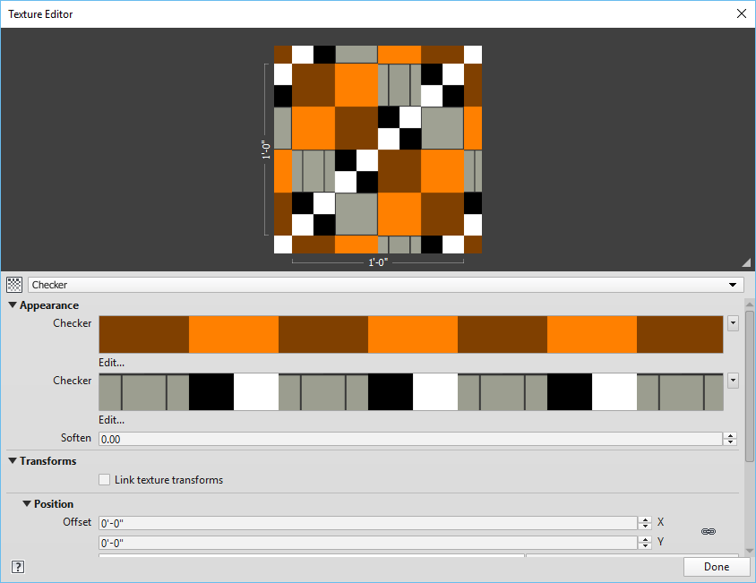

I work with Revit API and, seemingly, encountered a bug with asset content. To be more precise, while exporting from .rvt project a material with the following texture characteristics,Texture.png
in other words, textured material with a checker basic procedural texture and both 2 checkers as its sub-textures, I saw the following situation.
This can be described as follows: the first slot (asset["checker_color1"]) was exported correctly, since the method
  asset["checker_color1"].GetAllConnectedProperties()
 returned an attached asset, but the second slot was exported incorrectly, because the corresponding method threw an exception and "checker_color2" position was empty, although, as you can see above, there also must be an asset.
Looking forward to a response whether my notification was relevant or not.

I discussed the issue REVIT-99286 [API: sub-texture missing in material asset -- 12174739] with our development team, and they analysed it in depth.
That initial exploration case was first closed as 'Code Fix Needed', with a new case REVIT-99772 [API: sub-texture missing in material asset -- 12174739] generated from it for the actual development work to be performed.
However, on taking a second look, the development case has closed that as well as 'Cannot Reproduce' with the following explanation:
I cannot reproduce this issue in Revit 2016. I added layers of checker to a material's texture and with the API extraction I can see each layer being found and readable. I did not have the customer's model, nor did I experiment with the debugger syntax indicated.
I suspect it's more likely the developer has a typo in his code rather than anything else.
I created a sample model with an embedded ShowMaterialInfo() macro set to read from the checker material which is saved within it.
You can scroll through the output and see the multiple layers of connected assets and their nested properties.
I extracted the development team code from their macro and added it to The Building Coder samples module CmdGetMaterials.cs in release 2017.0.130.4.
