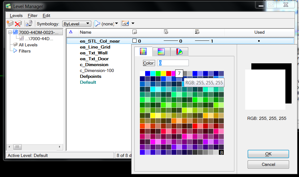

Hi Jeremy, we are doing a large project for the City of Toronto. Are client is TTC and we have to use a seed file with Revit 2015. I am running into conflict while using the seed file with Revit 2015 and the way it reads the LEVELS and COLOUR INDEX when it translates the Categories.
In these 2 colour index all colours are in wrong order eventhought Revit 2015 is using the RIGHT SEED FILE.
Below is the COLOUR INDEX exported from REVIT using ECLRT Seed file.dgn under the location shown ECLRT Seed 2D.dgn
Below is default ECLRT Seed file which is current where the COLOUR #7 reads the right code as per TTC STANDRADS (0,255,255)
