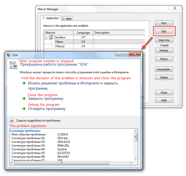

The process of launching revit.exe by Visual Studio in the Debug mode takes a time. It happens each time after editing and rebuilding of Add-In's code and in general it can take essential time. For saving of time I write my code inside of macroses. This is the reason why I use the built-in SharpDevelop. When code is debugged I move it into my Visual Studio project.
Now about of my question...
Each time when I press the Edit button of the Macro Manager dialog box I get the windows with the message:
> "SDA" program runtime is stopped.
This is the screen of that window (red colored text is my translation to english):
At the same time the SharpDevelop editor is opend without problems. I close the window with this message and use SharpDevelop. Then I attach to revit process and debug my code without problems.
Somebody faced with such problem? What can be reason of that error occuring? What this problem influences?

I found out that in the Process Manager window (Ctrl + Shift + Esc) I had a process with "SDA" name (even when the sessions of Revit and its built-in IDE SharpDevelop was finished). After I compulsorily finished manually of the SDA process - this problem disappeared.
