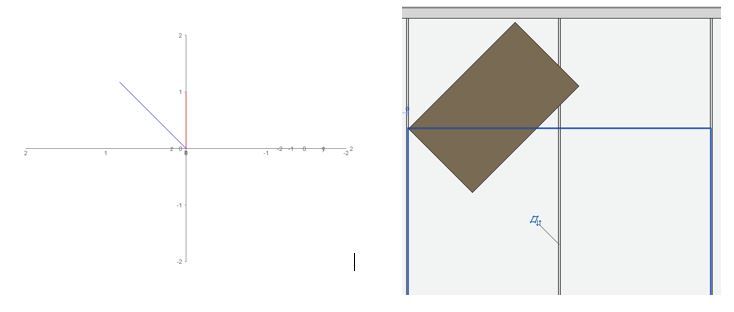

I've been trying to understand the rotation parameter to this function.  I want to put a 1 object on the face of another object and get it rotated correctly in 1 step.
I have a problem when the object is going along the North / South axis and I'm trying to place it on the East or West face of the object. I get the error "Reference direction is parallel to face normal at insertion point."  I can play around with the reference direction value, but I don't really understand why this is only a problem with the wall going in a certain direction.
Let me know if I need to provide some more information. Thanks!!

When using (0,0,0) it would come in like the image above.
I was finally able to get them to position correctly via the direction parameter, (1, 1, 0) was the magic XYZ.  Now I'm just trying to figure out how this rotates on the face exactly so that it makes some sense 🙂
I figured by hand the Face's Normal would be (1, 0, 0) in the project (since its a NS wall, pretty easy 🙂 ), so I'm guessing somehow these works with (1, 1, 0) to direction tile into the frame.  Just trying to figure out how exactly
Message 10 of 20
Oops I meant when I used (0, 0, 1) I'd get the position above.

I had a slight discovery this morning, not sure if this is correct or not but seems to be true for this element atleast.  I still have no idea how it decides to initially place the family, but when I was looking graphing the direction vector and the face normal vector and noticed something, it seems the amount the object is rotated is the same as the angle between the refernce direction and the face normal.  (After seeing your projection video, I think this might have to play a part in why a vector such as (1, 0, 0) does not work, but (1, 1, 0) does).
So if I give ref dir of (0, 0, 1) this is the same as the face normal, so it ends up rotation 0 degrees (or not at all):
So given reference direction (1, 1, 0), the angle between this and the normal is 90 degrees, so by providing this vector the element is rotated 90 from where it gets placed (in the graphs, red is the face normal).
Now, if I give say (1, 1, 1) as the ref dir, this gives an angle between itself and the face normal of 45 degrees, so the tile seems to rotate 45.
And some more playing with the ref dir seemed to continue this, the angle between them was the same the family got rotated.
I'm just working on now having the direction of the wall be used to figure the sign of the X and Y's of the reference direction so that it works for all wall directions.
Hopefully those pictures help some, seeing it visually helped me alot.
