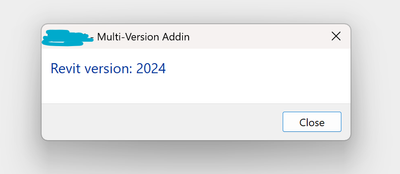

Hi @jeremy_tammik
I found that the simplest solution to maintain the same code base for 2025 and earlier is to put the TargetFramework in a condition.
Here is step by step:
  • Create a dotnet 8 class library project
  • Reference Revit 2025 dll's (RevitAPI.dll and RevitAPIUI.dll, set Copy Local to No)
  • Create configurations '2024Debug' and '2025Debug' (or release)
  • Edit the project file and put the TargetFramework and the Reference in a condition:
 <PropertyGroup Condition="'$(Configuration)' == '2024Debug'">
   <TargetFramework>net481</TargetFramework>
 </PropertyGroup>
 <PropertyGroup Condition="'$(Configuration)' == '2025Debug'">
   <TargetFramework>net8.0</TargetFramework>
 </PropertyGroup>
 <ItemGroup>
    <Reference Include="RevitAPI" Condition="'$(Configuration)' == '2024Debug'">
     <HintPath>..\..\..\..\..\..\..\..\Program Files\Autodesk\Revit 2024\RevitAPI.dll</HintPath>
     <Private>False</Private>
   </Reference>
   <Reference Include="RevitAPIUI" Condition="'$(Configuration)' == '2024Debug'">
     <HintPath>..\..\..\..\..\..\..\..\Program Files\Autodesk\Revit 2024\RevitAPIUI.dll</HintPath>
   </Reference>
   <Reference Include="RevitAPI" Condition="'$(Configuration)' == '2025Debug'">
     <HintPath>..\..\..\..\..\..\..\..\Program Files\Autodesk\Revit 2025\RevitAPI.dll</HintPath>
   </Reference>
   <Reference Include="RevitAPIUI" Condition="'$(Configuration)' == '2025Debug'">
     <HintPath>..\..\..\..\..\..\..\..\Program Files\Autodesk\Revit 2025\RevitAPIUI.dll</HintPath>
   </Reference>
 </ItemGroup>
  •  Create an App.cs file and implement IExternalApplication
public class App : IExternalApplication
    public Result OnStartup(UIControlledApplication application)
        TaskDialog.Show("Multi-Version Addin", $"Revit version: {application.ControlledApplication.VersionNumber}");
        return Result.Succeeded;
    public Result OnShutdown(UIControlledApplication application)
  • Create an output folder for both versions ('c:\...\output\2024' and 'c:\...\output\2025')
  • Add a .addin file to your project for both versions (MyAddin2024.addin and MyAddin2025.addin)
<?xml version="1.0" encoding="utf-8"?>
<RevitAddIns>
  <AddIn Type="Application">
    <Name>MyAddin</Name>
    <Assembly>C:\...\output\2024\MyAddin.dll</Assembly> (or 2025)
    <FullClassName>MyAddin.App</FullClassName>
    <ClientId>{client id}</ClientId>
    <VendorId>{vendor id}</VendorId>
    <VendorDescription>{vendor description}</VendorDescription>
  </AddIn>
</RevitAddIns>
  •  Post-build events:
      echo Configuration: $(Configuration)
      if $(Configuration) == 2024Debug goto 2024
      if $(Configuration) == 2025Debug goto 2025
      :2024
      echo Copying results to 2024
      copy "$(ProjectDir)MyAddin2024.addin" "$(AppData)\Autodesk\REVIT\Addins\2024"
      copy "$(ProjectDir)bin\$(Configuration)\net481\*.dll" "C:\...\output\2024"
      goto exit
      :2024
      copy "$(ProjectDir)MyAddin2025.addin" "$(AppData)\Autodesk\REVIT\Addins\2025"
      copy "$(ProjectDir)bin\$(Configuration)\net8.0\*.dll" "C:\...\output\2025"
      goto exit
      :exit
  • Build both configurations
  • Open Revit 2024:
  • Open Revit 2025:
For debugging, add to the project file:
