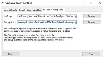

Hello, I have a problem with Revit Python Shell.
When I open Revit 2024, run StartupScript, it contains a script that exports the model to NWC.
Using Export method.
In the process of StartupScript I get the following error.
But if I open Revit 2024 first, and without StartupScript I run the same script through RevitPythonShell, then everything works fine.
If I run StartupScript example, with Revit 2021, I do not observe such an error.
The version of Navisworks Exporter that I use: is Autodesk_Navisworks_Exporters_2024_Win_64bit_dlm_R1
Revit version: 2024.2
Revit Python Shell version: 2.0.2
InitScript:
init.txt
Paths for startup.py and init.py:
c:\Users\%USERNAME%\AppData\Roaming\Autodesk\Revit\Addins\2024\RevitPythonShell\
startup.py:

studio-a-int
The error you get is because one of your views does not contain visible
3D Geometry (= suitable geometry) for Navisworks exporter.
You can create a method to filter for visible elements with suitable geometry
for each view you are exporting, and pass that while exporting.
If no suitable geometry, view will not be exported.
Or you can use a try/except condition, and catch all the views that
cannot be exported, write the list and then identify which views are empty.
Then open those views and make at least one object with geometry, visible.
Re-export, and you will not get the error.
