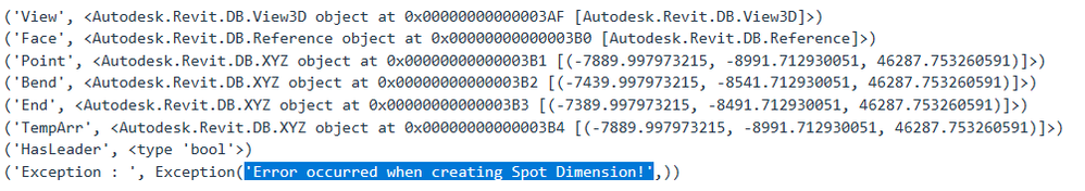

I want to use NewSpotCoordinate but error has occurred....:(
About code:
ERROR: 'Error occurred when creating Spot Dimension!'
Maybe the function's arguments are correctly entered.
I want to using NewSpotCoorinate Class....i'm waiting your reply...!

Maybe you cannot create a spot elevation in a 3D view.
Maybe you must be in an elevation view, like in this example:
https://thebuildingcoder.typepad.com/blog/2010/01/spot-elevation-creation-on-top-of-beam.html
You should always test that what you are trying to do is possible at all in the user interface before trying to attack it programmatically.

I'm sorry but I'd like to ask about spot coordinate, not spot elevation.
Is spot coordinate also difficult to execute?
