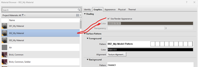

I have used the API to update the color in the Appearance tab. It's okay, however, the Shading color remains the old color. How can I fix this?

khanh_phamWU8FK
Hi Jeremy,
Thanks for response. If "Use Render Appearance" is checked, whenever you change the color of Appearance, the Shading color is changed accordingly.

Looking back at the screenshot in the OP however, I'm wondering if the issue is that setting it isn't producing the desired result since the box is checked but the color is incorrect.

khanh_phamWU8FK
Hi Gary,
Thank you, "the box is checked but the color is incorrect." => That's what I'm talking about

Message 10 of 16
khanh_phamWU8FK
The toggle can be set both manually in the UI and programmatically in the API. Both of those methods work for setting the toggle.
=> Correct.
When you set this toggle manually n the UI, it has the desired effect.
=> Correct.
When you set this toggle programmatically n the API, it has the desired effect.
=> I did not set this toggle programmatically. It's true by default.
I've just set the Appearance color programmatically and my expectation is the Shading color will be changed to the same, but Shading color is incorrect. The result as you can see from the screenshot.

GaryOrrMBI
I just ran a test using the Revit 2023 API and I can confirm this behavior.
Test 1: created a new material programmatically with thisMaterial.UseRenderAppearanceForShading = False
result as expected (direct control of shading color):
Test 2: created a new material programmatically with thisMaterial.UseRenderAppearanceForShading = False,
then manually checked the box in the UI. The resulting color and transparency values were generated as usual when creating a material in the UI (the shading color being derived by a combination of the color and bitmap properties that are set in the Appearance Asset):
Test 3: created a new material programmatically with thisMaterial.UseRenderAppearanceForShading = True
The resulting color was different than that generated in test 2 (even though all properties of the Appearance Asset were identical):
Test 4: Duplicated the material created in test 3 in the UI, using the same Appearance Asset as the test 3 material:
The result was the same as test 3. Unchecked the Use Render... in the UI. Hit apply. changed the Shading color. hit apply. checked Use Render... and: the color reverted to the unexpected color in Material 3 (expected result was the resulting color in Material 2).
Test 5: Duplicated Material 1 in the UI, using the same Appearance Asset as Material 1. Checked Use Render... and the result was the same as Test 2 (the expected derived color).
Test 6: Changed the Appearance Asset in Material 3 to use the one created in test 2. The derived Shading color was the same as in Test 2 (the expected derived color).
Continued changing Appearance Assets in the different test materials between those created programmatically as well as manually duplicating those Appearance Assets and assigning them using the UI.
As a final test, I moved the setting of the material properties to later in the code (after the creation of the Appearance Asset) and...
bingo!!! we have a winner. Everything started acting as it should act.
The final result and conclusion: The bug comes in the form of an Appearance Asset that is created programmatically after the Use Render Appearance value is enabled programmatically in the Material itself. This specific combination sets the derived color value to an unexpected value that somehow becomes cached in the Appearance asset.
@khanh_phamWU8FK,
Try creating and assigning the Appearance Asset before setting the Use Render... property on the material.
-G

Message 13 of 16
khanh_phamWU8FK
Hi Garry,
The solution you suggested worked remarkably well, and I am pleased with the outcome. Thank you once again for your outstanding support.
Message 14 of 16
GaryOrrMBI
I wouldn't actually call it a solution, more of a workaround while we hope for a solution.
One additional note:
It might not hurt (especially if duplicating a Material and/or Render Asset) to set the UseRender... property to False immediately after creating/duplicating the Material,
then create/duplicate the Appearance Asset,
then if so desired, change the UseRender... property to True.
This would help ensure that your new Appearance Asset doesn't get the "bug" to start with.
