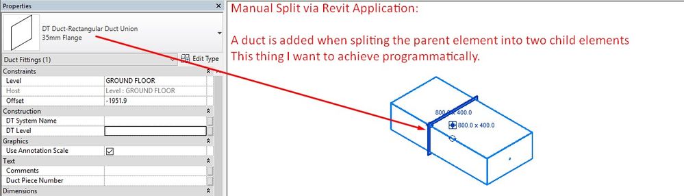

It will be great favor if you can help me in achieving my requirement.
Normally, if we split an duct from UI itself, then it adds an family instance i.e. duct between the two separated elements.
But by using the BreakCurve method it breaks the element into two parts at specified length which is really good, But I also need a specific family instance i.e. duct to be added between the two elements, just like we do from UI in Revit application.

Message 9 of 18
Hi Matthew,
Sorry for the confusion. I am not good at explaining. But still trying Smiley Happy
Below are some screenshots for before and after case when splinting an element via application and via api, both:
BEFORE:
AFTER
1. WHEN SPLITTING MANUALLY VIA APPLICATION UI:
a. Here you can see 3 elements. two are child elements that was created after splitting the parent element and 3rd one is the duct which act as a separation point between those two.
b. Here you can see the duct which was added when split occurred:
2. WHEN SPLITTING USING API (Via BreakCurve() method):
So, here i need a duct to be added between those two elements, just like i did using the split button from application.
I hope I am going in the right direction to explain my requirement.
Saurabh Dhir
Message 10 of 18
matthew_taylor
Hi @Anonymous,
Riiiiiiiight. You need to add a union fitting. That's not a duct; it's a duct fitting, and a familyInstance.
All else fails, describe the elements using the Revit descriptions, or the RevitLookup (API) names. That way it's obvious. 🙂
I originally used two transactions, but it appears a regen will do the trick:

Message 11 of 18
Hi Matthew,
Thanks for your assistance. Smiley Happy
It works great.
Yet, I have another issue. This method only works well if we are not modifying the element's orientation.
I tested this on a duct. I first added a duct and implemented the method just after placing an instance of that duct and it worked great.
But, If I rotate the element to its opposite direction and then implementing that methods throws multiple errors.
Do you have any idea how to resolve these.

Message 12 of 18
matthew_taylor
Hi @Anonymous,
The familyinstance needs rotating in the same orientation as the duct curve.
I'm sure there are plenty of examples of how to rotate family instances on this forum. Report back with how you get on!

Message 16 of 18
FAIR59
no need for the rotation , you can place the duct fitting with the right direction.
Dim famInstance As DB.FamilyInstance = doc.Create.NewFamilyInstance(breakPt, familySymbol, vector, null,  DB.Structure.StructuralType.NonStructural)
Ofcourse it can't hurt to learn how to rotate an element.
Message 17 of 18
Thank you so much,
It worked pleasantly Smiley Happy
