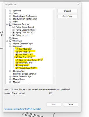

Mohamed_Arshad
Hi @gopinath.rajendran
     You can't able to delete the System Types, we can able to purge the system types. Kindly check the below link for additional reference.
Reference Image
Reference Links
https://forums.autodesk.com/t5/revit-api-forum/purge-unused-via-the-api/td-p/6431564
https://thebuildingcoder.typepad.com/blog/2017/11/purge-and-detecting-an-empty-view.html
https://thebuildingcoder.typepad.com/blog/2022/03/purge-unused-and-the-autodesk-camel.html
Hope this will Helps 🙂
