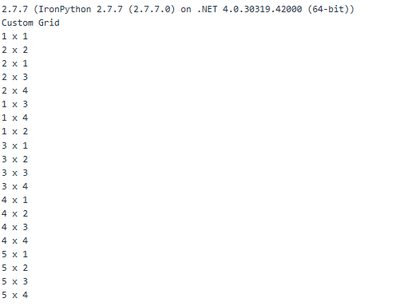

Output of
print(Element.Name.GetValue(famsymb)) using IronPython yields the expected list of family types.
