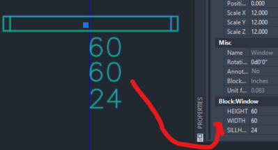

we have dwg files imported in revit that has blocks with attributes
in order to read this information we thought it was convenient to read it from a dxf format so we are exported the 3D view as a dxf format. However, the file is not mapping the attributes for the insert objects (block references).
Is there a way to get the dwg files imported in revit and export them in a dxf format (not the active view but the purely dwg file)? The reason is that we can read the attributes only if we use original dwg file in a dxf format
