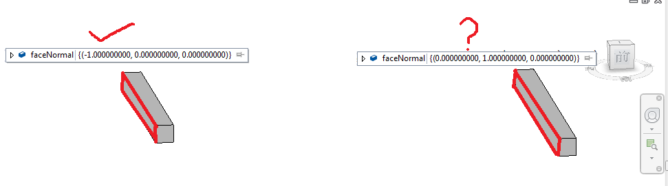

I created two beams through different codes. Their FamilySymbols are the same. But their left faces' (marked as red in pic)normal are different!
The face normal of the left beam is the same as I expected(-1,0,0).
The face normal of the right beam is wriong to me and I don't konw why. test.png
Attached is my project for your erfernce.

dragos.turmac
Hi @Anonymous,
It seems that one beam is bound to 标高2 as working plane, and the other one is unbound. Is this intended? This binding can influence the position of the FamilyInstance in WCS.

Hi dragos.turmac, Thanks for your quick response!
Bounding to a working plane is not my intention.
For the both beams I used Instance = Doc.Create.NewFamilyInstance(line, FamilySymbol, Level, StructuralType.Beam) to create them.
How can i avoid bounding to a working plane when creaing? Why and how working plane influence the FamilyInstance? If I can't change the way of creating the right beam how can i get the correct face normal like the left beam? Thanks!

dragos.turmac
You can try passing null for Level. Unfortunately it's not explicitly mentioned in the documentation, but the Level parameter is optional.
The beam, after all, it is a family; like every family, it has a local coordinate system. If you bind it to a plane, than it's LCS is might no longer be identical to WCS; it's local Z axis will correspond to the Z axis of the reference plane.
What you are seeing is the beam's face normal in LCS, that's why they differ even if they point in the same WCS direction.

I've downloaded your sample file and investigated the FaceNormals.
For each of the two Elements, there are six sides having FaceNormal values as expected, all pointing outwards (making my previous post obsolete).
May it be that you compare the faces by index, meaning the first face in the left element's face list is compared to the first face in the second one's face list ?
The geometry objects are not returned in order but randomized.
As far as I can see, there is no problem at all.

Hi dragos.turmac,
I passed null for Level and the right beam was bound to no working plane this time. But both beams' faces' normal are the same as previous.

I did further investigation. I found that I've added coping on the left beam before. So when I adding coping on the right one it works right! Why? ...

FAIR59
Your comment on coping is the last piece of the puzzle.
When a familyinstance is
  • cut,
  • joined
  • coped
  • and apparently has been coped
Revit has to calculate the solids of the instance "in situ" as it will be different from the solids from the family definition. So the normal of the face will be relative to the project.
In all (??) other cases Revit treats the solids as "instances" of the solids from the family definition. And by some Revit-logic, when asked for Face.ComputeNormal() it gives the normal relative to the family. Quirkier still it gives the Face.Origin in project coordinates.
So with familyinstances that are not cut, joined or coped, you need to transform the faceNormal to project coordinates.
As you have a reference to the face you can easily test for this condition:
refFace.ConvertToStableRepresentation(doc).Contains("INSTANCE")
So add this to your code:
                    if (refFace.ConvertToStableRepresentation(doc).Contains("INSTANCE"))
                        Transform trans = (selectedElement as FamilyInstance).GetTransform();
                       computedFaceNormal = trans.OfVector(computedFaceNormal);
faceNormal =trans.OfVector( faceNormal));
