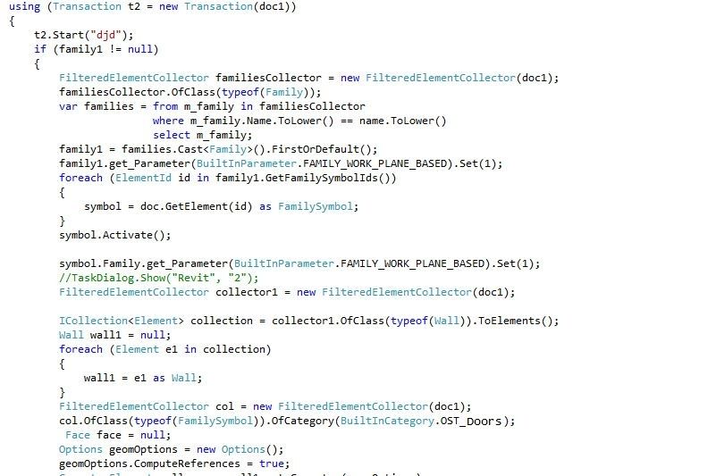

Please find attached image for updated coding to Import family instance to existing floor with specific location.
We had included the inferiorfaceref in the updated code.
Thanks for your supporting and giving the solutions, I will create new thread for place door in the existing wall and awaiting for your reply/suggestion.

Why do you share your code as a picture?
Code as text is mostly more useful. For instance, it is found by a search engine.
Regardless.
You are using the overload taking a face reference, a location, a reference direction and the symbol:
  FamilyInstance NewFamilyInstance(
    Reference reference,
    XYZ location,
    XYZ referenceDirection,
    FamilySymbol symbol )
The reference direction must be a direction, and is generally normalised.
(0,0,0) is not a valid direction and cannot be normalised.
I am therefore slightly surprised that this call does not fail, and would assume that it may well fail sometime in the future.
Why don't you specify a valid reference direction if you don't care about it anyway, e.g., XYZ.BasisX?

Hi Jeremy,
Thanks for your given suggestion, we had updated the reference direction code XYZ.BasisX, its worked fine.
