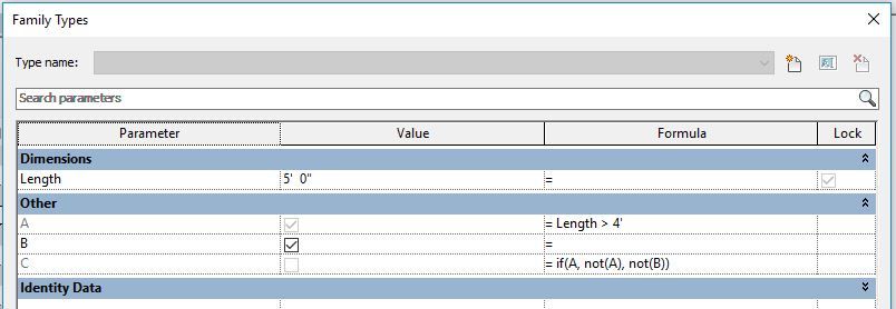

Hi, I have a question relating to this topic but can't figure out the solution.
I have three YES/NO parameters A, B, and C. Parameter A is only visibly when a certain condition is met and is working as intended. Parameter B is a simple tick box (YES/NO instance parameter).
What I want to achieve is the following: If  A=YES, then  C=NO. If  A=NO, then  C=NOT(B). I cant't manage to pour this functionality into a formula for parameter C. Anybody any idea's?
Message 28 of 58
Right now I assume you have certain conditions that control "A" being checked on unchecked.
Use the following equation:
C =IF(A, not(A), not(B))
If the conditions for A are met, then use the opposite of A. If not, then use the opposite of B.
Message 29 of 58
if(not(A), A, not(B))
Message 30 of 58
luis_brionesalonso
Works like a charm, thank you.
