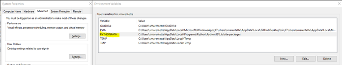

Ensure your environment variables have a variable called "PYTHONPATH" and is pointing to the location of the module you would like to import:
You may need to restart your computer after creating this new system variable for it to be recognized.

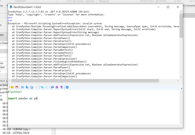

Thanks in advance. I am having this same issue trying to run pandas. I am getting back in to pyRevit, and as far as I can tell I have everything set up as it should be, and I have followed all the advice in this thread, and yet this still does not run.
I am using Spyder as an IDE, but trying to resolve this issue I have installed Python 3.10 on its own as well. I have added a PYTHONPATH in Enviromental Variables pointing to all sorts of folders. I have added Search Paths to all sorts of directories. Nothing seems to work. I either get the "pandas module does not exist" message or this "invalid syntax" error message.
Let me know what other information you might need. Your expertise is definitely appreciated.

That is revit python shell not pyRevit...
Message 10 of 20
shea.robisonSGEZR
Thanks for the response. RPS is how I am developing my scripts for pyRevit. I don't know of another way to test my scripts other than trying them out in the RPS first. I use Spyder to write the code in Python  and the RPS to check how the scripts work in Revit. If the script isn't working in the RPS will it still work in pyRevit?

Maybe you already figured it out, but anyway... In short, you can't.
RevitPythonShell is still using IronPython, so it can't handle libraries that are not pure python or those that only support python 3.x.
There's an open issue on RPS's github regarding this.
Until someone gets their hands dirty and implement CPython support in RPS, you're out of luck.
I generally code directly in visual studio code set up with ironpython-stubs for autocompletion, and use revitapidocs for everything else, then run the command directly in pyrevit (you don't need to reload pyrevit after editing a script, so it's not so bad).
Of course you'll lose the interactivity...
