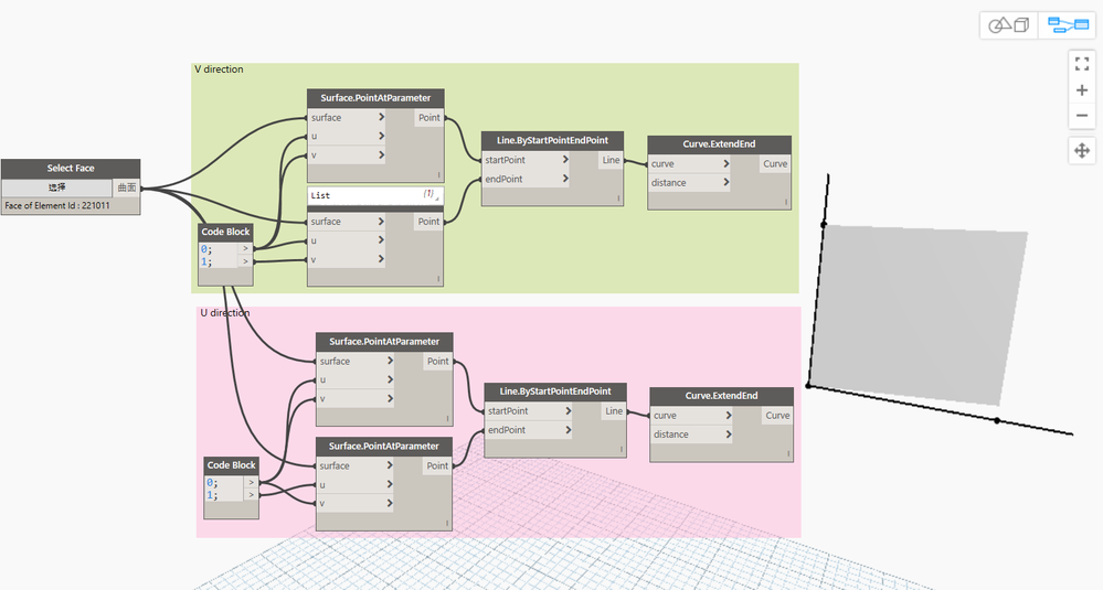

1120415118
Thanks for your replay, Jeremy Tammik.
Forgive my stupidity, I don't understand your method, but it inspired me to think of another way. I use Dynamo to query the U and V directions of the face, and I am glad to share it.
