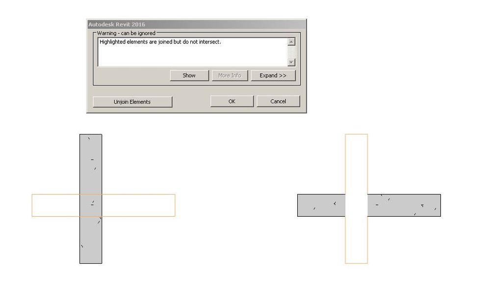

This error message

How can I control if there is a warning if 2 elements are not intersected. It can be ignored and continue to the loop with the others?Capture.JPG
