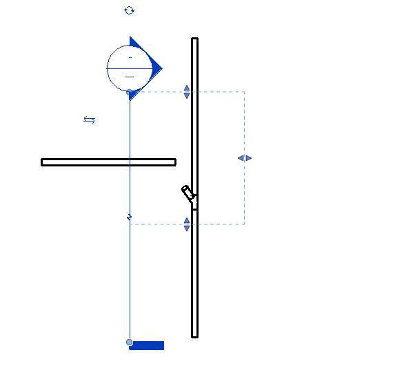

hi there,
I can get ViewSection's BoundingBoxXYZ、 Origin、ViewDirection
But i don't know how to get the CropBox's X,Y (like image dash line)
please help me, thank

pochao
Dear Jeremy,
thanks for your quickly response.
So i need to use Transform object to get coordinate?
My stupid method:
        Dim bb As BoundingBoxXYZ = MyViewSection.CropBox
        If MyViewSection.ViewDirection.Y = -1 Then 'UP
            minX = MyViewSection.Origin.X - (bb.Max.X - bb.Min.X) / 2
            maxX = MyViewSection.Origin.X + (bb.Max.X - bb.Min.X) / 2
            minY = MyViewSection.Origin.Y
            maxY = MyViewSection.Origin.Y + (bb.Max.Z - bb.Min.Z)
        ElseIf MyViewSection.ViewDirection.Y = 1 Then 'DOWN
            minY = MyViewSection.Origin.Y - (bb.Max.Z - bb.Min.Z)
        ElseIf MyViewSection.ViewDirection.X = -1 Then 'RIGHT
            maxX = MyViewSection.Origin.X + (bb.Max.Z - bb.Min.Z)
            minY = MyViewSection.Origin.Y - (bb.Max.X - bb.Min.X) / 2
            maxY = MyViewSection.Origin.Y + (bb.Max.X - bb.Min.X) / 2
        ElseIf MyViewSection.ViewDirection.X = 1 Then 'LEFT
            minX = MyViewSection.Origin.X - (bb.Max.Z - bb.Min.Z)
        End If
