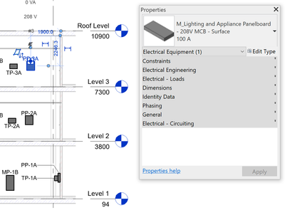

We want to get the Part Type information from Electrical Equipment in Revit API.
Kindly suggest how can we get the Part Type information as per attached screenshot.

I analysed the two MEP sample projects provided with Revit and looked at various electrical equipment objects:
  • Open rme_basic_sample_project.rvt
  • Select Electrical Equipment PP-3A
  • Add-Ins
  • RevitLookup
  • Snoop current selection
I see no Mechanical section or Part type entry in its properties:
Same result looking at the advanced sample project:
Please explore your own model with RevitLookup and let us know the result. Maybe your electrical equipment differs from the sample project content.
