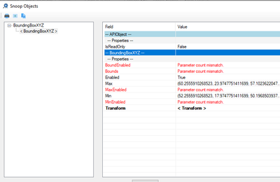

For 2D if used below
BoundingBoxXYZ boundingBox = room.get_BoundingBox(revitDocument.ActiveView);
In 2D min,max are
(52.255591027, 17.974775141, 50.196850394)}
{(60.255591027, 23.974775141, 57.102362205)
min,max are important in my case because calculating room size by this.
as whole purpose of getting bounding box to get room size.
as i am going to highlight those room with any dimension having less than 10 feet.
so it is coming less than 10 feet in 2D for same room it is not coming less than 10 feet for 3D.

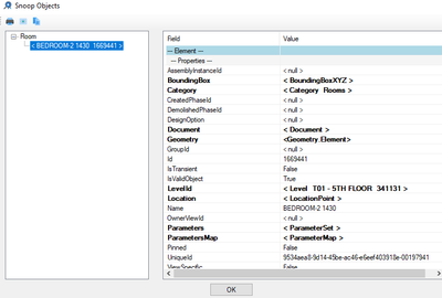

purpose of second and third image is when model is open in 2d got result expected unlike image 1.
for below model
could you comment for room having id 1669441.
why in 3d not getting right result?
 also tried to search element id by click on manage select by id and then search for 1669441.
when it is in 3d element not searched.but when model is in2d it get seached.
