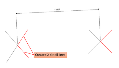

I am trying to create a dimension between the intersection points of detail lines in a drawing, as shown in the image.
While I managed to create a dimension using some workarounds (since I couldn’t directly reference the intersection point), the dimension is not associative. This means that when I move any of the detail lines, the dimension does not update to reflect the new intersection point—it stays in its original position.
Workaround Attempts
1. Creating Small Detail Lines at Intersection Points – Placing short detail lines at the intersection and using them as reference.
2. Using Endpoints of Detail Lines – Creating two detail lines at the intersection and using their endpoints as reference.
However, in both cases, the dimension is not associative, meaning it does not update when the detail lines move.
I also tried creating a point using the Point.Create() method, but the reference returns null.
Can someone help me resolve this issue?

Message 2 of 8
jeremy_tammik
Maybe you can create a constraint to ensure that your helper objects remain in the correct position and move with the target objects when needed.
Another possible approach, but probably more programming effort and also more execution overhead, might be to implement an updater using the DMU framework.

gopinadh7XTGG
Hi @reylorente1,
Thank you for quick reply.
Please Try moving a single line at a time to adjust the intersection. This will help you see the error more clearly.
Preview
Message 6 of 8
gopinadh7XTGG
Hi @jeremy_tammik,
Thank you for the suggestion. I couldn't find any APIs for constraints. The only constraint option I found in Revit is the Equal constraint, which ensures selected dimensions are of equal length.
Could you suggest how I can apply a coincidence constraint between the start/end points of my helper lines and the intersection point?
Message 7 of 8
jeremy_tammik
Afaik, this requires you to align the two constrained objects, create a linear dimension between them (which will show zero distance) and lock the dimension. Here is how Mistral le Chat formulates that suggestion:
