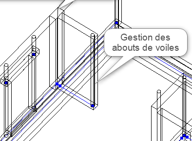

My goal is to automatically place a stiffener at the end/start of each wall.
To do this, I need a point. I already know how to place and contrain a stiffener from a placement point.
My concern is how to find said placement point.
