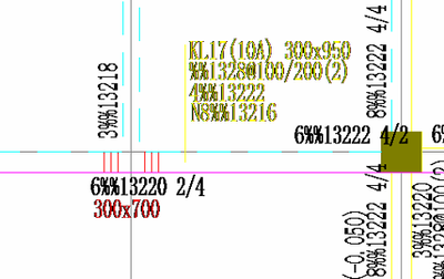

I link the dwg by the tool of revit  below:
and we can see it  below, and I wanna know how to use the API to create beams by the lines standing for beam in dwg?
what should I do ?  should I use the API to select lines representing beams first ? and what to do next ..

I have a question,it is a whole piece after linking dwg into revit, like below it is a image dwg linked into revit:
211.pngwhen I select,it becomes like below:222.png
I can't select a single line ,there is any API to break down it into many lines so that I could select any line ?
there is such API to make it true?
and I have another question ,how to pick these text like below by API?    thanks very much,I am looking forward to your help
Message 7 of 27

Message 8 of 27
27925916
I have used the same way to pick,like below:
I mean when I pick , I want to  pick the single line like picture 1,not a whole dwg like picture 2:2221.png
                                                                                                      Picture 1
                                                                                                            picture 2
is there any API to breakdown the whole thing like picture2,so that I can use pickobject to select any line in it like pickture 1?
Message 9 of 27
matthew_taylor
Your geoObj object is the line (or text etc).
It's not an element, so you can't 'select' it, or highlight it, but the code I gave you allows you to retrieve the line and its properties.
If you want to simulate selection, you may be able to do that by creating detail or model lines over top of the geometry.
Cheers,
-Matt

Message 10 of 27
27925916
how to create detail or model lines over top of the geometry,?   retrieve all lines and text and create detail or model lines over them?
  I find revit has a function: when I select the whole block of dwg linked into revit, a button appears  like picture1:
PICTURE 1
and when I click it, the dwg block breakdowns ,and it is no problem for me to pick any lines or text in this dwg block like below:
I am confused how it realizes? is it also useing the way creating detail or model lines over top of the geometry?
but if I click Esc , it becomes back again, which is a whole dwg block again.
that is to say ,this button can allow us to pick any lines or text in a whole dwg block. how it do..Smiley Embarassed

I understand what you are trying to do. The Revit API doesn't support selection for non-element objects (as far as I know).
The visualisation is not the important part of your coding. (You would probably do better to turn them straight into beams anyway.)
Here's a proof of concept:

Message 13 of 27
27925916
it is possible for me to pick after exploding after linked DWG file using the API?
 I need to realize function that allows user to pick lines or text in dwg linked into revit,
if it is impossible, does it have the API to have a operation to pick different Layers in dwg linked into revit?
thanks very muchSmiley Embarassed

27925916
Smiley EmbarassedI am so confused that I make a new topic about the same question...
yes ,I have used the way you advise to get the name of  'layer' about a line, and alse I can use it to get the  'layer' of text like below :text.png
but the GraphicsStyleCategory.Name is not the content inside it , and is there any way to get the content of it and its position?
because I want to judge the relationship of the lines standing for beam and the text whcih describes the size of beam
