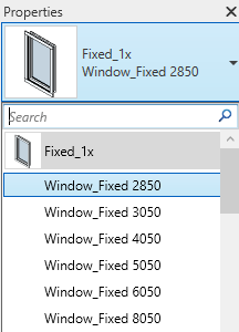

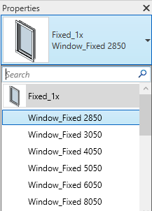

How can I access the name of family type used for any instance? I have a family of window named as "Fixed_1X" which further has family types as shown in below snap.
How can I access name of the family type for any family instance. I want to retrieve a string "Window_Fixed 2850" for this example. Any suggestions @jeremytammik @naveen.kumar.t @RPTHOMAS108 @architect.bim ?
I'm getting name of the FamilySymbol (Fixed_1X) using below syntax.
string symbolName = (element as FamilyInstance).Symbol.Name;
When I try below syntax familyTypeName returns "FamilySymbol".
string familyTypeName = (defaultWindow as FamilyInstance).Symbol.GetType().Name;

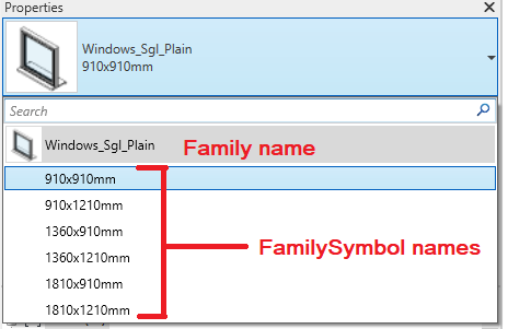

Best way to resolve these kinds of questions is to use RevitLookup and work back from there.
If you want the name of the FamilySymbol you get the FamilySymbol from the document via it's id (FamilyInstance.GetTypeId). That object then has a name.
You can likely also get it via parameters on the instance.
Stringing long lines together with dots is not the best way to understand what you are getting at each stage e.g.
string familyTypeName = document.GetElement((defaultWindow as FamilyInstance).Symbol.GetTypeId()).Name;
In the above the member GetTypeId is available at Element level of inheritance and when you use Element.GetTypeId it will return the id of the ElementType for that Element.
Also FamilyInstance.Name often reflects its FamilySymbol.Name anyway so I'm not seeing the complication here perhaps? It is harder to get FamilyName directly (FamilySymbol.Family.Name). However you say you are getting 'Fixed_1X' that is the name of your Family in the above UI image.

I've already tried it with Revit lookup but couldn't navigate the name of the family type . I can access the family name but I couldn't access the name of family type for any specific instance placed in model. I'm trying to access the family type name i.e. "Window_Fixed 2850" in this case.
