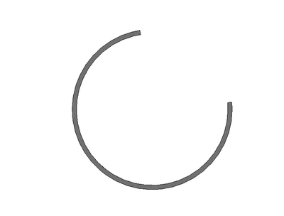

It refers to finding directions of points on the curved wall.

SimonaQQ
It sounds like: finding the tangent direction at a certain point on the curve.
If that is indeed the case, Curve.ComputeDerivatives, this Api returns a Transform where BasisX is the tangent direction at this point.
Message 11 of 11
josenlee34_21
Something like this. Any random point on the curved surface will do
