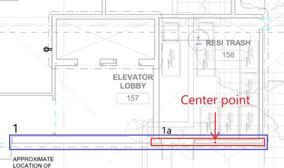

However, some walls are longer than edge of the room as this photo
Basically, 1 part is a wall of the Resi Trash - 158 room (blue border).
So, I want to get the 1a part (red border) which has located inside the room and getting the center point of the 1a part.

You can use the boundary Curve to find the midpoint on the RoomWall  ( and the direction into the Room ).
List<Tuple<Wall,XYZ,XYZ>> walls = new List<Tuple<Wall,XYZ,XYZ>>(); // Item1 = wall, Item2 = midpoint, Item3 = direction to Room
IList<IList<BoundarySegment>> boundaries = room.GetBoundarySegments(new SpatialElementBoundaryOptions());
foreach (IList<BoundarySegment> b in boundaries)
	foreach (BoundarySegment s in b)
		Element el = doc.GetElement(s.ElementId);
		if (el is Wall)
     			Wall wall = el as Wall;
       			Curve cv = s.GetCurve();
       			XYZ mid = cv.Evaluate(0.5,true); // midpoint on BoundaryCurve
       			// XYZ midpointOmWall = (wall.Location as LocationCurve).Curve.Project(mid);
       			XYZ directionToRoom  = cv.ComputeDerivatives(0.5,true).BasisX.CrossProduct(XYZ.BasisZ).Negate().Normalize();
       			walls.Add(new Tuple<Wall,XYZ,XYZ>(wall,mid,directionToRoom));

ddk0705
Thanks @FAIR59  I think it's a good solution.
