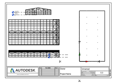

I have been working on a Revit Addin and, so far, the end result is in the image bellow:
However, I want the Level Heads visible in the viewports to the left, the elevation markers and the axis arrows in the right-most viewport to not be visible. Bellow is parts of the code I have so far:
CreateView.cs (Creates views visible in the left-most viewports):

What is missing here? I've been having this issue for a while so any feedback is appreciated.
Also, bellow is the test .rvt document and the .sln document for the addin.

joaofmoco
I have figured the solutions for my issue and I'll leave the corrected code bellow:
CreateViewCommand.cs:

            collector3DViews.OfClass(typeof(View3D));
            List<View3D> all3DViews = collector3DViews.Cast<View3D>().ToList();
            // Filtered Element Collector for the Floor Plans
            FilteredElementCollector collectorFloorPlans = new FilteredElementCollector(doc);
            collectorFloorPlans.OfClass(typeof(ViewPlan));
            List<ViewPlan> allViewPlans = collectorFloorPlans.Cast<ViewPlan>().ToList();
            // Filtered Element Collector list for Sheet Views
            FilteredElementCollector collectorSheetViews = new FilteredElementCollector(doc);
            collectorSheetViews.OfClass(typeof(ViewSheet));
            List<ViewSheet> allSheetViews = collectorSheetViews.Cast<ViewSheet>().ToList();
            // Grab created Sheet View
            ViewSheet sheet = allSheetViews.LastOrDefault();
            // Grab default level 1 floor plan
            ViewPlan level1 = allViewPlans.First(n => n.Name == "Level 1");
            // Grab all created Views
            View3D v1 = all3DViews[all3DViews.Count - 3];
            View3D v2 = all3DViews[all3DViews.Count - 2];
            View3D v3 = all3DViews[all3DViews.Count - 1];
            // Get id list of Project Points
            List<ElementId> basePointIds = new FilteredElementCollector(uidoc.Document, level1.Id)
                .WhereElementIsNotElementType()
                .OfClass(typeof(BasePoint))
                .ToElementIds()
                .ToList();
            // Get id list for the view's Elevation Markers points
            List<ElementId> viewElevationMarkerIds = new FilteredElementCollector(uidoc.Document, level1.Id)
                .OfClass(typeof(ElevationMarker))
                .ToElementIds()
                .ToList();
            // Get id list of the elements regarding the NSWE building sections on the level 1 view
            FilteredElementCollector viewerCollector = new FilteredElementCollector(doc, level1.Id)
                .OfCategory(BuiltInCategory.OST_Viewers);
            // Get building elevation Ids
            IEnumerable<ElementId> elemIds = from Element d in viewerCollector
                                             where doc.GetElement(d.GetTypeId()).Name.Equals("Building Elevation")
                                             select d.Id;
            // Create a list with the building elevation Ids
            ICollection<ElementId> hideMarksIds = elemIds.Cast<ElementId>().ToList();
            // Get id list for axis arrow y on level1 view
            var internalOriginCollector = new FilteredElementCollector(doc, level1.Id)
                .OfClass(typeof(InternalOrigin))
                .ToElementIds();
            // Modify document within a transaction
            using (Transaction tx3 = new Transaction(doc))
                tx3.Start("AddViewToSheet");
                // Edit level1 to fit criteria
                level1.DetailLevel = ViewDetailLevel.Fine;
                level1.Scale = 300;
                if (basePointIds?.Count > 0)
                    level1.HideElements(basePointIds);
                if (viewElevationMarkerIds?.Count > 0)
                    level1.HideElements(viewElevationMarkerIds);
                if (hideMarksIds?.Count > 0)
                    level1.HideElements(hideMarksIds);
                if (internalOriginCollector?.Count > 0)
                    level1.HideElements(internalOriginCollector);
                // Set default viewport to "No Title" type
                ElementType elementType = new FilteredElementCollector(doc)
                    .OfClass(typeof(ElementType)).Cast<ElementType>()
                    .Where(x => x.Name == "No Title").First();
                doc.SetDefaultElementTypeId(ElementTypeGroup.ViewportType, elementType.Id);
                // Add 4 viewports, 1 for each view
                Viewport viewport1 = Viewport.Create(doc, sheet.Id, v1.Id, new XYZ(0.45, 0.25, 0));
                Viewport viewport2 = Viewport.Create(doc, sheet.Id, v2.Id, new XYZ(0.45, 0.85, 0));
                Viewport viewport3 = Viewport.Create(doc, sheet.Id, v3.Id, new XYZ(0.45, 0.55, 0));
                Viewport viewport4 = Viewport.Create(doc, sheet.Id, level1.Id, new XYZ(1.10, 0.55, 0));
                tx3.Commit();
            return Result.Succeeded;
Thank you all!
