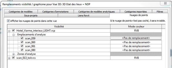

Yes, I can put on invisible the rcs from a rcp instance, have a look on the capture joined.
I can use GetScans() and return the list of all rcs drom my rcp instance.
With LookUp, no way to get the ids of all .rcs...

But how to access the rcs id ?
