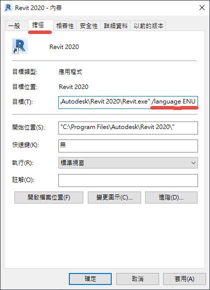

Hi @Anonymous,
Try this:
Right click on your Revit shortcut on your desktop and choose "Properties"
At the end of target cell, set "/language ENU"
You can replace ENU to other languages you like e.g. CHT for Chinese Traditional or JPN for Japanese.

Thanks for the tip.
But I tried that already. It was ENU as it is supposed to be.

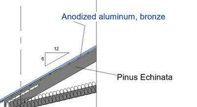

I would argue that this IS, in fact, a question for this forum, considering that it is a question about the user interface and the I/O of files? I've having the same issue, where Revit 2024 changes the language of existing assets/tags/materials to the language of an imported detail or hatch, without any way to correct it.
Again, since this is an issue of Revit's labguage automatically changing in response to a filetype saved in a different language, I believe this would fall under the purview of API questions, would it not? I understand this is not third-party app development, but nobody else is more capable/qualified at rooting out the issue of what's going on than developer support such as yourself.
If not, I apologise, and then request that @autodesk  create additional forum topics so that there is a category this type of question would fall under, since this category - in its insufficiency - is still the most relevant. That and add a way for posters to change the Forum a question is asked in after posting.
I haven't imported any materials, only those two stone/gravel hatches highlighted above, yet a whole bunch of settings have changed. Any ideas on who I can change the language settings of the affected categories and then change how Revit responds when importing other objects so this doesn't happen again?
