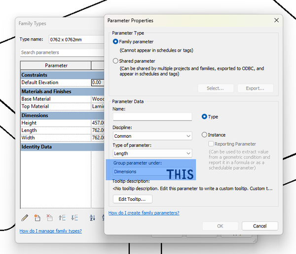

I'm working on a plugin that batch processes global settings. I am facing a problem: I can't get values ​​for "Group parameter under": Not all values ​​are included in this list.
What am I doing wrong?
        static public List<string> AddingGroupingOptionsToDictionary(Document _doc)
            List<string> parameterGroupNames = new List<string>();
            FilteredElementCollector collector = new FilteredElementCollector(_doc)
                                         .WhereElementIsNotElementType();
            foreach (Element elem in collector)
                foreach (Parameter param in elem.Parameters)
                    BuiltInParameterGroup group = param.Definition.ParameterGroup;
                    string groupName = LabelUtils.GetLabelFor(group);
                    if (!parameterGroupNames.Contains(groupName))
                        parameterGroupNames.Add(groupName);
            return parameterGroupNames;
 Thanks in advance for your reply!

Message 2 of 8
sragan
I'm not sure offhand.  It looks like you are going through every parameter of every element in the file, and getting that parameters group.   It seems like there should be an easier way.  At any rate, it makes testing the code very difficult.
When I compile, I get 3 warnings.   Maybe try using these newer methods? See the attached image.

Message 4 of 8
2lenin-off
I hope there is a method that will accomplish this task without errors and much easier.
I get a lot of parameters that are not in the list.
Message 5 of 8
2lenin-off
So, with all the options for forming the list, I either got extra elements, or some elements were missing.
As a result, I compiled a list of elements myself: I hope it will be useful to someone.

Message 6 of 8
sragan
I'm not sure how you would get extra elements.
But with the code you were using, if a particular parameter group isn't used in any elements in the project you have open, it's not going to include that parameter group.
Message 7 of 8
GaryOrrMBI
2023 and prior had a BuiltinParameterGroup Enumeration that you could parse through.
That Enum no longer exists as they have fully transitioned to ForgeTypeId to define these values.
I have not found a method of parsing those or separating them by what they apply to (everything that uses ForgeTypeId all gets lumped together).
Here is a snippet in VB that I used to be able to use to print them out (similar for any of the former Enums, most of which have been replaced by ForgeTypeId references and can no longer be acquired in such a manner) to a txt file:
