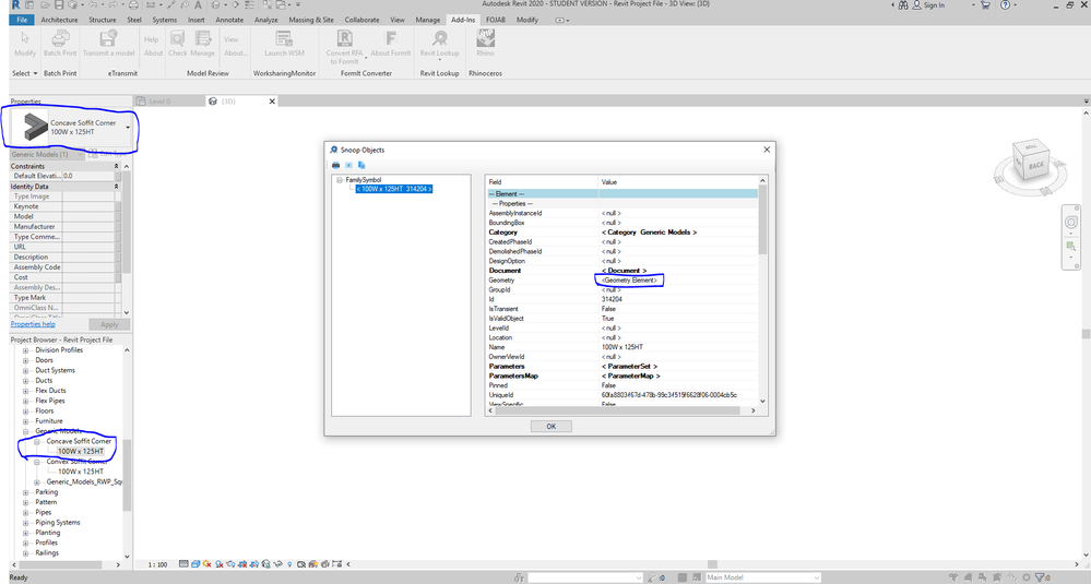

Hi Guys,
How can I get the geometry from a Family Symbol that is loaded in the document?.
When I check the familiy via the Revit Look Up add-in it seems not to return anything. In addition, whenever I try something like:
 if (!furniture.IsActive) furniture.Activate();
GeometryElement geoEl = furniture.get_Geometry(m_options);
geoEl is always null
Any tips would be great.
Nicholas

Hi Jeremy,
thanks for your reply. Yes, I don't see the furniture in the model, I can only select it in the project browser tab under the generic model category. As for the m_options I set is as:
 m_options.IncludeNonVisibleObjects = true;
I have run the debugger and and geoEl is always null

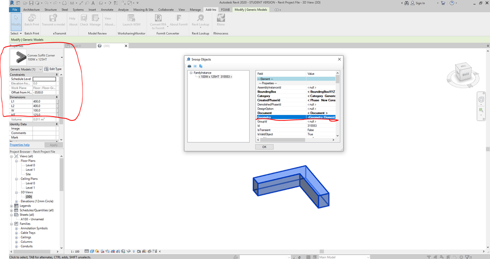

Hi @jeremytammik
The family symbol does have geometry
Only when I place a family instance via the NewFamilyInstance() method I am able to see other properties in the properties tab when I select the family, as well having access to the geometry.
I guess this is only available once the instance is placed in the document?
Is there a way to get access to this information beforehand?
Nicholas

FAIR59
You have to check, if the familysymbol is active. If the symbol is active the geometry is accessible
FamilySymbol symbol;
if (!symbol.IsActive) symbol.Activate();
Maybe you need a document.regenerate() after .
In the options you can specify the DetailLevel. Try setting the detaillevel to ViewDetailLevel.Fine.
