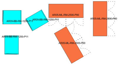

When tagging an element in the UI, Revit automatically picks up a certain point for the tag which, as far as I know, seems to be related to the visible solids. Is there a way to get this point without having to resort to some convoluted maths?
I'm creating tags via the API and I've tried the LocationPoint and the center of the BoundingBox but neither are ideal.
Manually via the UI (the desired result)
Via LocationPoint (it looks like it's the origin point in the family)
Via center of BoundingBox (these families have different family types at different sizes, which is probably causing the bounding box to be bigger than the visible element)

Thanks for the reply. I went through these links and I can see how they are useful if you are tagging doors. Fortunately, doors is not something I'm trying to tag at this point in time and those articles are very specific to deal with arcs from doors and not helpful to me. In fact, if you check the list of links I put in the post, the first one is about doors.
I'm trying to tag supermarket refrigeration cases, which are mostly rectangles and should be simpler than doors. The only tricky part about them is that they have several family types at different sizes, which is affecting the position of the tag if I try to use their BoundingBox.
Thanks again.
floretti
I just realised I worked out a solution but never posted it in case someone needs it but here it is.
