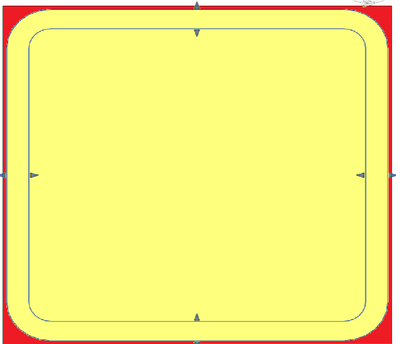

Let me present it in more details, the red area is the difference between the received bounding box and the actual element:
It is 1/16" and it has an effect on our tools.
We need a precise accuracy and we do get it in most of the cases and this is the reason that we use the solid and not just the original get_boundingbox method.
The fact that it works for other kinds of direct shapes proves that something is wrong in this specific case.

When I say bounding box in the specific case of the solid, this is what I mean:
https://www.revitapidocs.com/2015/716fecd9-7d09-fa61-5c02-de714259a214.htm
The goal is to get a minimal bounding box and this is why we are working with the solid.
As I said, in most cases, it works.
After further investigation, we discovered that this happens if at least one of the corners is round.
I hope this also helps.
