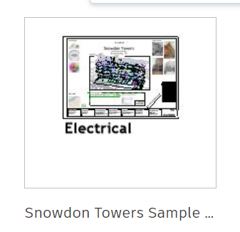

this were my code . The project i was testing on is actually the Snowdon tower Sample project in Revit 2024
what i found interesting is ActiveView of all OST_ElectricalCircuit will automatically change to the level which is oppening. That's why it display all the circuit. in the code i was acctually display all the active view of all circuit, even they are at different level but they only show the current level.  I think this is error because Active view work fine with other but not the circuit. Thank you
