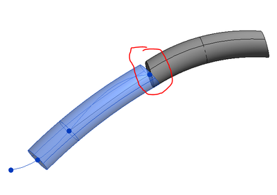

Greetings from South America, I've been struggling quite for a long in automating the placement of generic model adaptive families to follow a path. Let's say the following element represents my adaptive family (this one consists of 4 adaptive points)
So my goal is to place various instances of this family following a path in a way that the faces at the end and beginning of each connection make a perfect plug without overlaps. So far, I've been trying to add an extra adaptive point to the family so whenever I place a new instance its starting face's direction can follow the trend. However, I've not succeeded at all as you can see below:

Any suggestions on how to approach this task in order to align those consecutive surfaces by using generic adaptive models?

RPTHOMAS108
This problem seems to come up a lot e.g. tunnelling rings etc.
I tend to think that instead of one path you can define three parallel i.e. three points define a plane so three points at each profile of the form would define the orientation of the end profiles. A neighbouring profile could therefore match those same three points to marry up two profiles. Points would have to be fixed at same parameters of each circle. You often have these ideas but then you may find a limitation that means they can't be done that way you envisaged. If I were investigating I would explore that in the UI can't say at this stage it is doable.
When you created the form you didn't pick both the profiles and the curve i.e. form seems to follow just the profiles. Seems the end profiles are not perpendicular to the tangent of the end of the curve by points and solid is not following the curve.
