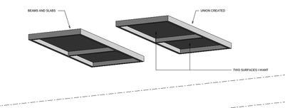

Hey Everyone, I am trying to get the surfaces between the beams on the bottom of the concrete deck(soffits).
I create a union between the beams and slabs and then iterate though the faces  but it only gives me a face count of 13. It should be 16. I tested the same think in dynamo got the geometry, created a union, and then got the surfaces and the count was correct.
Can someone guide me in the right direction on how to get the surfaces I am wanting?
CREATED UNION IN REVIT:

@jeremy_tammik Thank you for the response i will update the script to use the almost-equal to method. But I count my faces before i filter by the face normal. So it should be giving me the full count of all the faces (i would think). Unless its not reading the union correctly and its still viewing the elements as separate instead of one piece of geometry. Do you have any ideas on how i could get the two bottom of slab sections as separate faces?

Looking again at your union with my feeble fallible human eyes, I count:
  • 1 top face
  • 4 outside side faces
  • 8 inside side faces
  • 1 or 5 bottom faces?
Sum total 14 or 18.
So maybe I am wrong, or Dynamo, or your Revit API code, or all of us.
I would suggest graphically displaying each separate face to find out what is going on in some way, e.g., by drawing different colour model curve elements along their edges offset by a certain distance, for instance like I did here:
https://thebuildingcoder.typepad.com/blog/2010/05/curtain-wall-geometry.html

@jeremy_tammik So its not really combining my geometry into a solid when i create the union. its more of a group...
The only face that joined is the bottom of beams the other faces of the elements are just counted as normal
10 - beam sides
1 - beam bottom
1 - bottom of slab
1 - top of slab
i dont really understand why this would be though if im creating a union from all those elements shouldnt each intersection create a new face? Did i create the union incorrectly?

It appears to be counting the long beams on the inside faces as 1 face instead of 2. its not splitting the two long beams at where the middle one intersects them.

Yes, of course, faces can consist of disjoint parts:
https://thebuildingcoder.typepad.com/blog/2017/10/disjunct-outer-loops-from-planar-face-with-separat...

I figured out a way that worked for me. Thank you for your guidance as it got me to the final solution.
Created took the floors geometry by itself and got its Z elevation. Then used a dictionary to store the collected data and then later compare the z elevations from the "Beam and  Floor Union" and the "Floor" by itself.  If the values are equal then its the bottom of the slab.
