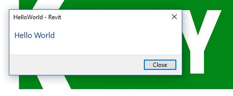

So, following all the the links on this subject, I'm having a bizarre result following the "Hello World" tutorial.
I've changed "Use manage combatibility mode" per discussion here;
When I use (F5) to start the debugger, Revit opens as expected, then I'm thrown a debug exception immediately after the prompt for an "untrustworthy publisher".
The debugger returns this message;
When I launch Revit manually, my "Add in" loads correctly and functions per expected;
