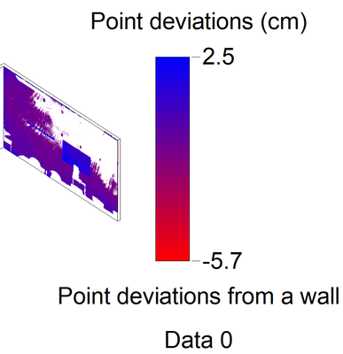

Let me summarize the different ways to apply a colormap to a point cloud for those who are interested with this subject.
I first tried to set the Colorfield of points contained in a PointCollection directly in my foreach loop. Unfortunately, it seems that I can access the Color of a point (point.Color) but I can’t set it. My understanding is that points in PointCollection are in a read-only mode but perhaps I am wrong.
Therefore, I had a look to the Analysis Visualization Framework (AVF). Thank you very much Jeremy, I didn’t know AVF. AVF enables to draw color graphics on the screen in a Revit Project. The results data is transient; it is stored only in the model until the document is closed. There are two options:
OPTION 1: AVF – Analysis display with markers
A new point cloud is created and colorized based on the deviations from the wall. This requires XYZ points and values attributed to these points (distances from the wall in my case). In order to do this, the point cloud has to be splitted into smaller ones (it is recommended to create multiple primitives with no more than 500 points; I tried multiple primitives with 1000 points and it works). Additionally, the number of points is limited to around 800000 according to my readings.
Display with markers - Visual Style: Hidden LineDisplay with markers - Visual Style: Hidden LineDisplay with markers - Visual Style: WireframeDisplay with markers - Visual Style: Wireframe
OPTION 2: AVF – Analysis display on wall surface
Wall face is colorized based on deviation values. This requires UV points i.e. points in the local coordinate system of the wall and values attributed to these points. I calculated the projection of the XYZ points into the wall face to obtain the UV points (IntersectionResult ir = face.Project(p); UV uvpoint = ir.UVPoint;). Of course, I have to separate the deviations for the two sides of the wall.
Display on surface - Result offset from the wall faceDisplay on surface - Result offset from the wall face
The benefit of using markers is that we can see occluded parts of a wall. For a colorized surface, color values are also assigned to occluded parts (interpolation of the color even if there is no points). But perhaps a colorized surface is more suitable for visualization purpose because markers are located both inside and outside the wall. I can use the Wireframe visual style to see all the points but it make the colormap disappear (see images above). I still don’t have decided which option is the better one. I have to do some tests on a bigger project with much more points to determine which is the most suitable.
The last thing I have to address is how to manage the views. I am not familiar with views in Revit. Currently I use the default 3D view to display the result but I would like to create a new view with only the analyzed wall and the result of the analysis. However, I don’t want that this view affect the others.
