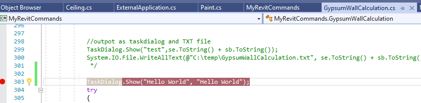

Hi ,
i get in trouble while trying to go through lesson 4 .
i succeed to lunch up revit in "Start External Program".
The AddIn manifest file is up-to-date to right location.
Then i chose line with breakpoint but when i start debugg the visual studio doesn't stop to "Step By Step" at any line, it just go through it and pass over.
any update on this lesson? i try to find the best way to pass through the code and find out some bugs .
Thanks in advance

Lack of hitting break points usually indicates you are pointing to wrong assembly location or VS isn't attached to the process.
Check:
Build > Configuration Manager
Has 'Active solution configuration' set to Debug
Check:
Path of the dll file location in manifest file (.addin) is matching relative 'Output path' on Build Tab within the properties of your visual studio solution. The path saved in the sample may not be where you saved the project solution. Although I would have expected you to get an error if the assembly file wasn't found.

@RPTHOMAS108  thanks for respond
i have just double check what you mention in your comment.
i make sure the manifest file point to the correct address and check about the configuration manager.
see the attached picture.
the breakpoints doesn't stop the code and its just pass through it.
any other ideas??

You are creating a .Net Standard library. Do you require cross platform support or are you not using Windows?
https://docs.microsoft.com/en-us/visualstudio/debugger/troubleshooting-breakpoints?view=vs-2019
The main suggestions above are to try alternative break point positions or turn off 'Optimise code' on the build tab. I'm not that familiar with .Net Standard so I don't know if there are any specific peculiarities with that which may need to be accounted for.
The lesson you mention has a project solution associated with it but that is not what you are using so you are not following lesson 4 as such.

Thank you so much !!! @RPTHOMAS108  ,
i wasted  too much time on that issue!
the things is probably due to the ".Net Standard" . i guess it because this is my first plug in and i missed something on the guide and chose a wrong framework.
i dont know how to fix it up so i start over a new project step by step and finally success!!
