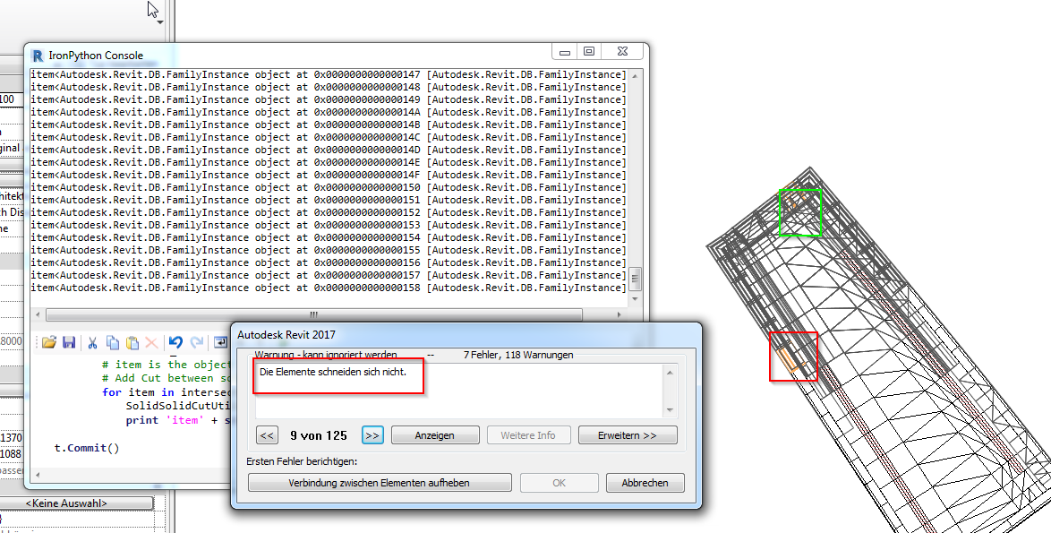

Hey Ruben, thanks a lot for your Input. yes true API is no Magic but I tested on small scale having only three attaching elements and everything worked fine. Now on larger scale it seems Revit finds intersecting objects which actually do not intersect. Since I read a lot about Troubles with bounding boxes especially using Python I was thinking whether it might be relied to the code. Attached please find a screenshot you see in green my object to cut out with the error warning "elment cannot be cut" but signing to a complete different Location of object.
I hope that makes my Problem clearer...

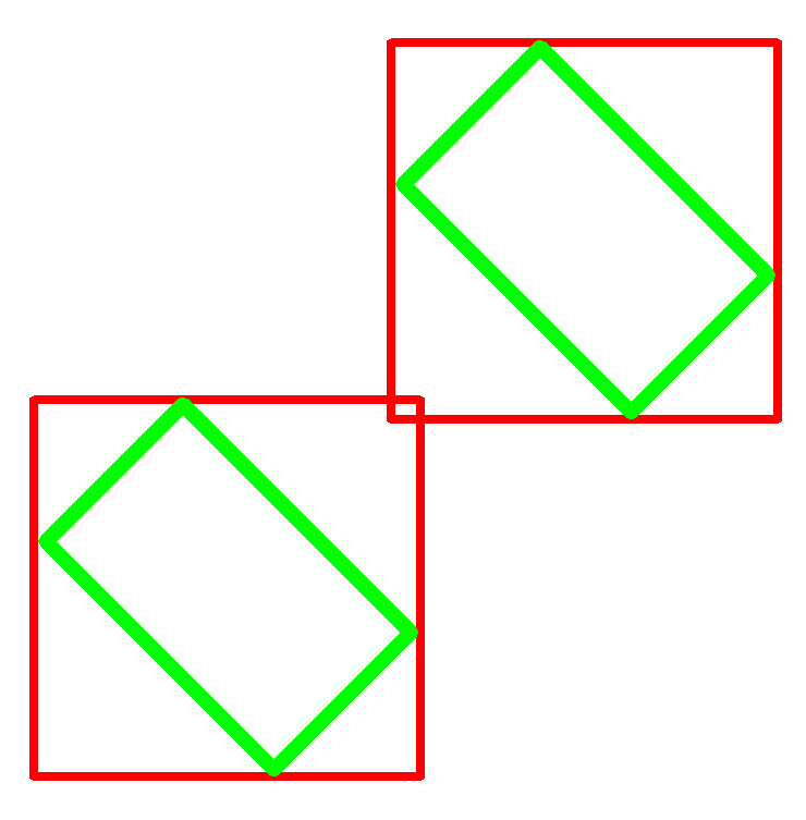

The first time I ever tried the BoundingBoxIntesectsFilter I was surprised at some of the elements returned as intersecting my element.  After closely reading the docs it dawned on me what was happening.  That filter returns items whose bounding boxes intersect, not elements who intersected my element's bounding box.  Notice in the attached image that the green elements clearly do not intersect, but their red bounding boxes do.  The BoundingBoxIntersectsFilter therefore will capture these elements.
Bobby C. Jones
