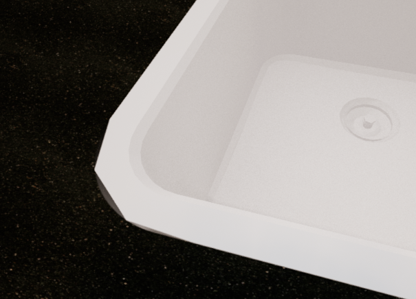

As shown in the screenshots below, when I tried to export a curved surface, the OnPolyMesh method in IExportContext gives very jagged edges. Is there a way to solve this?
Thanks!

Not very much you can do, I believe.
You should however at least read these two posts:
I all else fails, you will have to access the real element geometry instead of using the custom exporter.
That is normally a lot more work, though.

My solution is to triangulate the face in OnFace method, in this way I can input a LevelOfDetail parameter. However I lose all UV data at the same time. Currently I use Face.Project to approximate a set of UV which is quite unstable.
Thanks for your reply anyway!
I've also tried to set LevelOfDetail property on ViewNode, and it also works.
