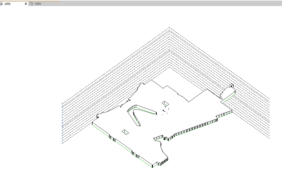

I work with models that contain Gross Building AreaPlans with their respective Areas and AreaBoundary lines.  The goal is to use the AreaBoundaries to extrude a solid, into a GenericModel per Level.  This can be achieved in Dynamo, but is not reliable and has difficulty with more complicated geometry.  Trying with a Python node gives me an 'internal exception' where the NewExtrusion is called.
Trying with pyRevit, it gives a 'managed exception' where the NewExtrusion is called.  Here is my script:

Unfortunately, afaik, GetBoundarySegments is not guaranteed to return the segments in any specific order.
I would suggest just creating ,model lines first to ensure that the extrusion can be executed successfully when you drive it manually through the end user interface, cf.
Message 3 of 9
HI @jeremy_tammik @loren_routh
     I think @loren_routh trying to create Extrusion in Project Template. Actually We don't have support to create In-Place Families in Revit API.
     I have a workaround to fix this. Get Points of the boundary and Create a Solid using BRep Bulilder Class.
In B-Rep you can able to create a Solid Extrusion (Kindly check the sample code in above link). And Convert that into Direct Shape.
Hope this will helps 🙂

I tried the GetRoomBoundaryAsCurveLoopArray() method, and it totally worked!  You need to import the ExporterIFC module, etc.   This method eliminated a chunk of code, no sorting or extracting the curves.  It let me create an extrusion (manually) with no errors at all!  As you can see by the pic below, this was not a rectangle.  Definitely has my vote to be included in the regular Revit API.  Now to make it work with Generic Models...

curve_loop = ExporterIFCUtils.GetRoomBoundaryAsCurveLoopArray(selected_area, opt, True)
with DB.Transaction(doc, "Create Model Lines") as tx:
    tx.Start()
    sketch_plane = DB.SketchPlane.Create(doc,selected_area.LevelId)
    for loop in curve_loop:
        for line in loop:
            crv = doc_create.NewModelCurve(line, sketch_plane)
    tx.Commit()
