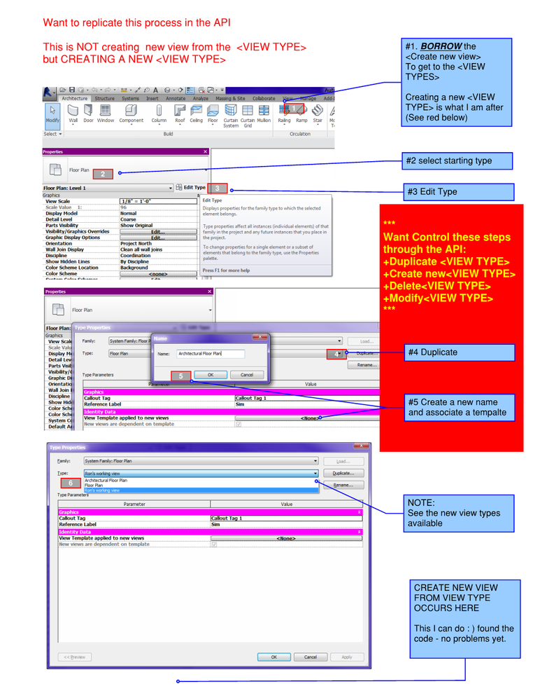

Is there a way to create/remove view types through the API?
To clarify what I mean-  manual process in Revit is here: (Create a view type)
You can create view types for plans, elevations, sections, 3D views, drafting views, legends, and schedules.
  1. Open a view for which you want to create a view type, or click the view name in the Project Browser.
  2. In the Properties palette, click Edit Type.
  3. In the Type Properties dialog, click Duplicate.
  4. Enter a name for the new view type and click OK.
  5. In the Type Properties dialog for the new view type, specify a value for each Graphics parameter.
I haven't found reference in the API yet- but just started searching. Seems to be scarce and I am a little concerned as you cannot get view types thorugh a transfer project standards.

Looking for Revit API help to create/modify a View //Type// name (from which views to place on sheets can be created). Not create a view from a view type.
Tough to spell this one out : )

Perhaps you are thinking about something like what the attached images show? The first is of an add-in that tries to do the bulk of the tasks for creating views. This one creates floor plans and ceiling plans for standard MEP disciplines and adds view parameter values for two view parameters. It also can apply a view template. The second image show a add-in for deleting. They both work curiously in a flash.

Attached the equivalent manual process: (PDF IS EASIER TO READ)
Ron Allen
Galloway BIM
Message 8 of 27
Necessity is the mother of invention. You are showing just five steps. I think I'm showing at least three more. Multiply that by the 270 views shown in the image. That's why we strive to get it all down to one button press. You are welcome to whatever I've got. Maybe 95% of all the various tasks you need to do are already figured out, perhaps not elegantly, but functional.  It is just a matter of transmission. I have yet to figure out how to attach a file to a post. How did you attach a PDF? I was thinking maybe I could disguise a zip file as an image file and then attach. It's probably breaking the rules.

@Anonymous No, Sorry. I am not creating views.  I am creating <View Types>
Views are created from <View Types>(that part I can do : )- but I need the prior steps in the API to create VIEW TYPES. Explicitly, I need  to know if the API can replicate steps 4 and 5.
Your app could create the view types once the view types were established. I had this conversation about 4 years ago and the it is difficult to convey- hence the PDF.
I may create resort to a screen cast if the PDF is not sufficient.

@jeremytammik Apologies- things sat quiet for a few days, and I am trying to stay ahead of the issue : )
Apologies to all on this thread- It is difficult to convey what I am after : ) - hoping the updated diagram helps (Attached a more readable PDF of it)
Explicitly I am looking to Replicate steps 4 and 5 in the API. Creating a <VIEW TYPE>.
The solutions offered so far show how to create <VIEWS> from <VIEW TYPES>, But I need to create the <VIEW TYPES>.
These are probably the most underused feature of Revit as most people are unaware it is there.

@Anonymous - That may be it!
I will have to check that out tonight and this weekend : )
