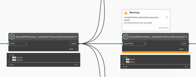

Hi! I am trying to create a C# method, that transforms a Mesh to Solid object. it came out as an issue from Dynamo, as Dynamo solids are converted to DB.Mesh when Unwrapped.
My initial approach was to use the TessellatedShapeBuilder class. I would simply get each triangle from the mesh and try to add it as a new face in the builder. Here's the code:

However, I only got an 'Internal Error' as a result:
I then noticed there are 12 triangles and 12 normals for a simple cuboid, which means each planar face is divided in two triangles (logically). So I thought maybe adding two triangles, that usually form a single face might be causing the issue. That's why I've decided to sort the triangles in a dictionary and add the ones, having identical normals under the same key. Then after cleaning duplicate points I would get the correct XYZ list so that a face can be formed properly. Here's the updated code:

Unfortunately it didn't work again. The error I got was that one:
Any suggestion would be of great help 🙂

mhannonQ65N2
This is a .NET error. On line 40, you are modifying the collection that you are enumerating. You cannot make changes to a collection while you are enumerating it via a foreach loop. I recommend that you make a list of the changes you want to make to the dictionary, add items to that list from within the loop, then, after the loop finishes, apply all the listed changes to the dictionary.
