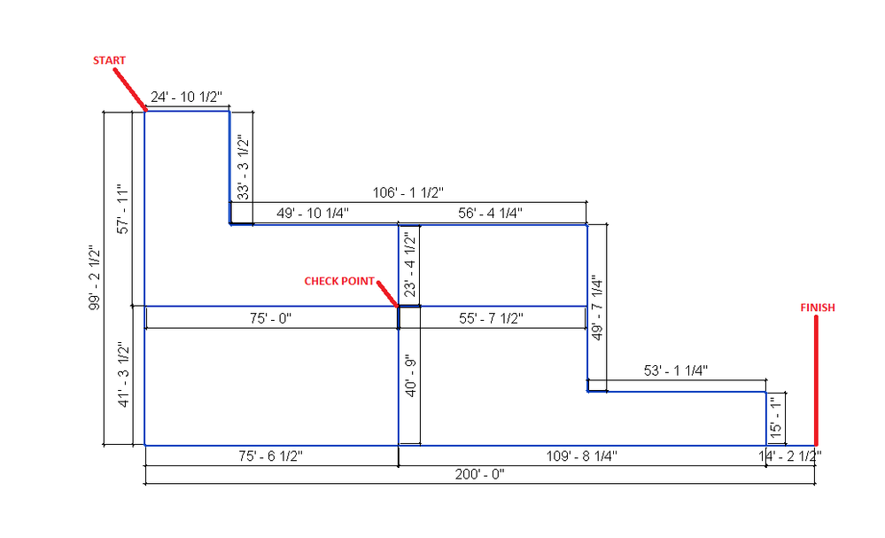

So it seems to me that you have a couple options on your hand.  You can:
  1. Let the user pick their own route
  2. Offer the most direct route
  3. Offer the shortest route (Not necessarily the same as #2)
  4. Take a path that passes points (like if you have some kind check system everything needs to pass)
Based on that, you'll have to do some math & logic on the search process.  Check out the image below (it's pipes - not ductwork...  but same principal):
You'll encounter tons of systems that have an infinite number of ways of laying them out.  In the drawing above, if you were to go from start to finish taking the "direct route", which may be the least amount of turns, you'd go straight down south, the east - covering 300' of pipe/ductwork in your case.  If you wanted the shortest route, you could take the top route (follow the most northern pipes) and you would only pass through 296' 1/12" of pipe...
Never presume to know what the user wants...  Most users will all have different ways of doing things - from East Coast to West Coast; North to South America and Europe...  If you want to give them options (which I would always recommend for enhanced UX), give them options.  Otherwise just build what you can, and add to it later.
If you really want to explore this and make a powerful tool, look at the differences between depth-first vs breadth-first searches, which are intended for graph systems like this:
