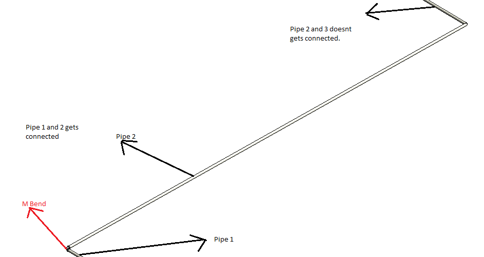

Diidn't understand what was googled for me.
A simple question I have two pipes pipe1 and pipe2
Neither of them works successfully to connect two pies:
1. doc.Create.NewElbowFitting(c1end,c2start);
2.c1end.ConnectTo(c2start);
c1end is the connctor of pipe1 and c2start is the connector of pipe2

Message 9 of 11
The image below will clarify things:
Tried:
try
Command.doc.Create.NewElbowFitting(c1end, c2start);
catch (Exception sdq)
MessageBox.Show(sdq.Message.ToString());
Tried Thsi:
try
 tried this
try
But it creates the fittings between pipes in one place but not at the other.
