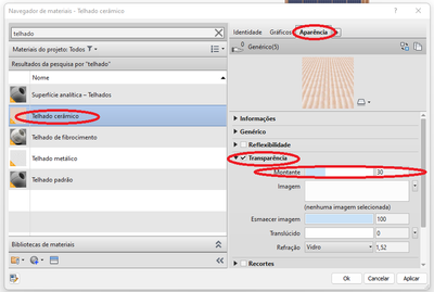

I'm trying to change the transparency of a material's appearance. The image below depicts the point I'm dealing with; I want to change the amount of transparency.
First I search for the material in the material manager, then I go to the appearance properties and finally I edit the transparency amount
