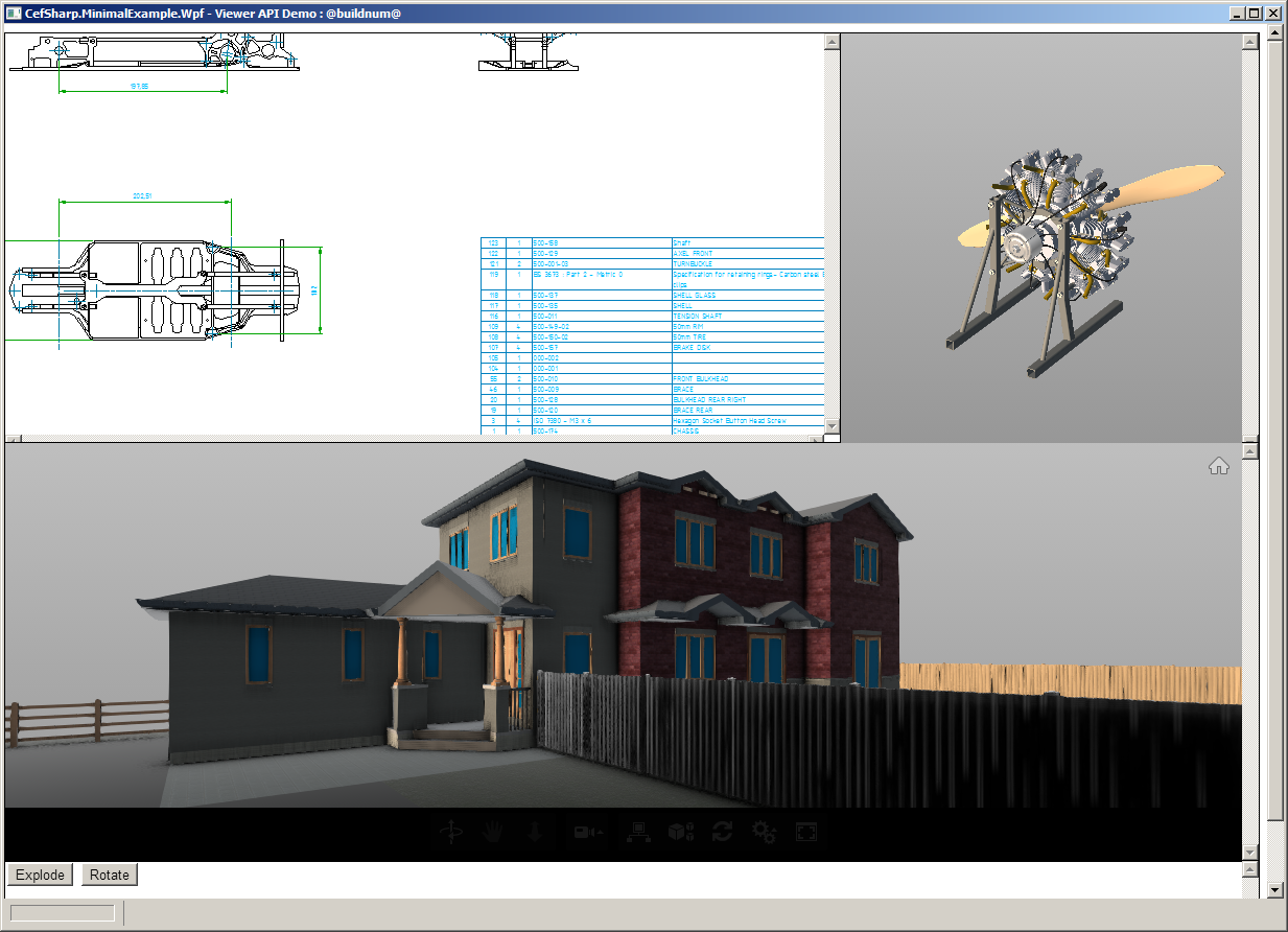

I am trying to integrate CEF Sharp WPF (Chromeium Browser) control into Jeremy Tammik's Dockable Dialog.  I seem to be able to integrate the package, but the browser will not render.  Has anyone else tryed to do this?  Any pointers would be appreciated.  Thanks..
CEF Sharp is here: https://www.nuget.org/packages/CefSharp.Wpf/49.0.0-pre02
Dockable Dialog is here: https://github.com/jeremytammik/DockableDialog
The image below shows the current status... Thanks..

Dear Paul,
Thank you for your query.
Yes, I spent a significant amount of time working on that exact topic.
Actually, I was working on displaying the Autodesk View and Data API viewer inside a Chrome or CefSharp control in a Windows form in a Revit add-in.
I gave it up in the end, though, and apparently never published that work.
I got bits and pieces to run, but it was very fiddly indeed.
CEF depends on a number of DLLs, and is extremely picky in the versions it requires.
As far as I remember, I got it to run using certain specific release DLLs, but not the debug ones, or vice versa.
I was also unable to integrate the CEF stuff to compile in the same project as my Revit add-in.
I am appending the state of my work as I left it when I gave it up in December 2014 to this message in cefsharp_RvtChrome.zip.
To make your mouth water, I am also attaching some images that I made back then.
The situation is probably much better today that it was back then, though.
